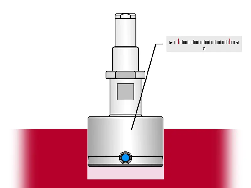

Marameter 844 D-M
Art. no. 4484464
844 D-M Indicating plug gage
Nominal size: >140-150
Measuring span in mm: 0.6
Connection thread g: M10x1
Design: For general holes, with extended measuring range
| Product type | 844 D-M |
| Measuring range mm | >140-150 |
| Measuring span | 0.6 mm |
| Repeatability fw (µm) | 1 µm |
| Manufacturing tolerance | -0.035 / -0.045 |
| Dimensions | a 17.9 mm | b 38.8 mm | c 33 mm | e 4 mm | |
- For rapid testing of diameter, roundness and conicity of bores
- Especially suitable for testing batches with wide tolerance zones
- Rocking in the bore is not required to determine diameter
- Ideal for use in conjunction with digital display units and for subsequent processing of measured values
