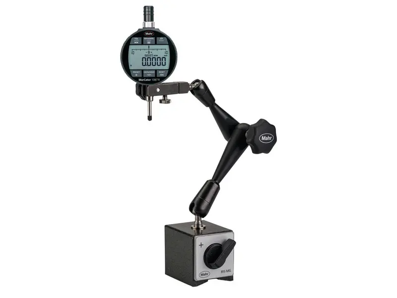

MarStand 815 MG
Art. no. 4420370
Measuring tripod with magnetic base MarStand 815 MG
Total height 390 mm
Projection (max.) 280 mm
Mounting hole: 8H7
- 3D jointed arm, can reach any position within the operating range
- Easy positioning of all three joints with a securely fixed handle
- Maintenance-free mechanical clamping system
- Black anodized arm components made from high-quality light alloy
- Dial indicator holder with 8 mm mounting bore and dovetail for dial test indicator measuring devices
- Fitted with zero-play micro-precision adjuster
- Very powerful switching magnet
| Fine adjustment range mm | 5 mm |
| V-block for shaft diameter | 6 - 120 |
| Adhesive force prism | 800 N |
| Mounting hole | 8H7 |
| Total height | 390 mm |
| Projection (max.) | 280 mm |
| Base surface | 60 x 50 x 55 mm |
| Dimensions | a 390 mm | b 280 mm | d 8 mm | j 170 mm | k 110 mm | l 49 mm | |
- For general measuring tasks in production and workshops
- High flexibility and stability, ideal for display devices with a resolution of up to 0.01 mm (.0005") such as dial gauges or test indicators
