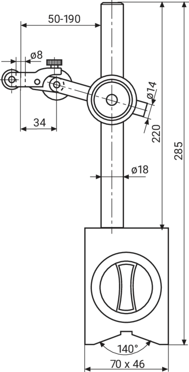

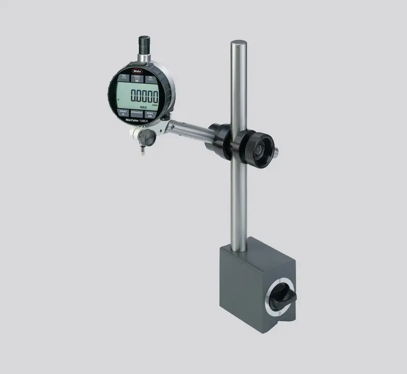

Measuring tripod with magnetic base MarStand 815 MB
Total height 285 mm
Projection (max.) 190 mm
Mounting hole: 8H7
- Support arm fitted with joint
- Powerful ON/OFF magnet
- Magnetic force transferred via flat and prismatic base and front of the machine base
- Stainless steel column and support arm
- Fine adjustment at support arm
- Display unit can be swiveled by ± 90°
| Fine adjustment range mm | 2 mm |
| V-block for shaft diameter | 20 - 100 |
| Adhesive force prism | 450 N |
| Mounting hole | 8H7 |
| Total height | 285 mm |
| Projection (max.) | 190 mm |
| Product weight | 2.2 kg |
| Dimensions | |
