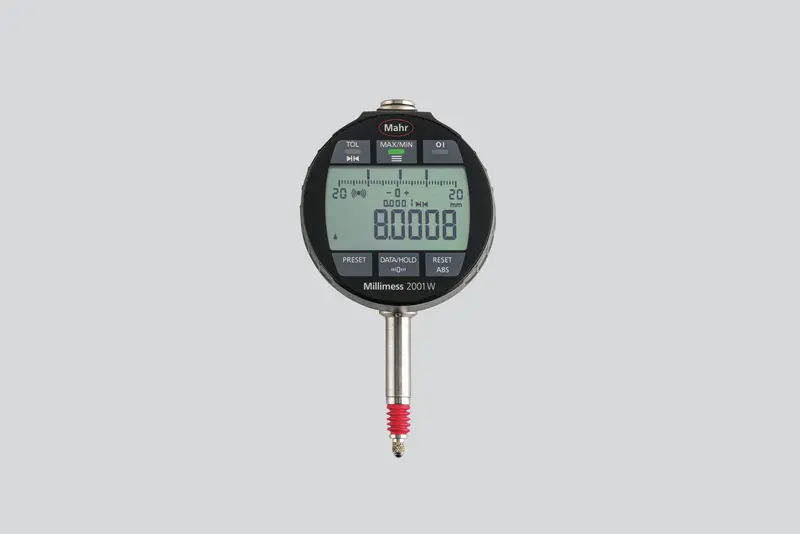

Millimess 2001 Wi
Art. no. 4346801
Inductive dial comparator
IP protection category: IP 64
Factory standard
Measuring span in mm: ± 1 mm
Resolution: 0.0001, 0.0002, 0.0005, 0.001, 0.002, 0.005, 0.01
Resolution inches: .000005", .00001", .00002", .00005", .0001", .0002", .0005"
Supply voltage: 100-240 V
Package contains: USB data and charging cable type DK-U1, Plug-in power supply (with 4 interchangeable adapters) for USB, rubber bellows, Screwdriver for pre-stroke adjustment (hexagon socket 0.9 mm), test certificate, instruction manual, Cardboard box
| Product type | 2001 Wi |
| Measuring range mm | ± 1 |
| Measuring range inches | ± .04" |
| Resolution | 0.000005 inch , 0.00001 inch , 0.00002 inch , 0.00005 inch , 0.0001 inch , 0.0002 inch , 0.0005 inch |
| Resolution (inches) | 5.0E-5 inch |
| Measuring value hysteresis fu (µm) | 0.3 µm |
| Repeatability fw (µm) | 0.1 µm |
| Height of digits | 9 mm |
| Range of analog display mm | ± 0.002 , ± 0,004 , ± 0,01 , ± 0,02 , ± 0,04 , ± 0,1 , ± 0,2 |
| Range of analog display inches | ± .0001'' , ± .0002" , ± .0004" , ± .001'' , ± .002" , ± .004" , ± .01'' |
| Battery type | Lithium polymer accu 3.7 V |
