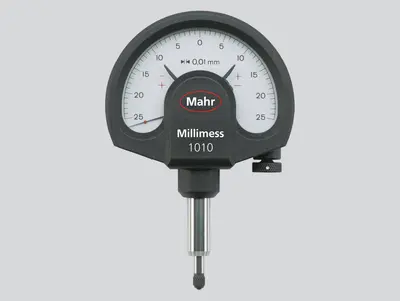

Millimess 1010 T
Art. no. 4332005
Mechanical dial comparator Millimess 1010 T
Factory standard
IP 54
Measuring range mm: ± 0.25 mm
Graduation value mm: 0.01
Package contains: test certificate, case
- Large, high contrast dial face
- Lockable fine adjustment screw
- Shockproof movement
- Measuring spindle is mounted in a high precision ball guide for minimal hysteresis
- Resistant to lateral forces (side play) acting on the measuring spindle
- Maximum sensitivity and accuracy are ensured by the jeweled movement in conjunction with the precision gears and pinions
- Box type protective housing
- Constant measuring force
- Measuring spindle can be retracted with either a screw in cable release or with a lifting knob
