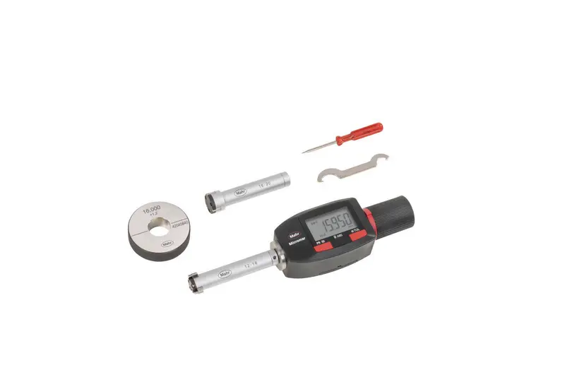

Micromar 44 EWRi
Art. no. 4191341
Digital 3-point inside micrometer - in Set Micromar 44 EWRi
For measuring of:
- Through holes
- Blind holes
IP protection category: IP 65
DIN 863-4
Measuring range 12 - 20 mm mm
Package contains: Basic unit 44 EWRi-g, measuring heads 44 Ak, setting rings, battery, instruction manual, case
| Micromar 44 EWRi | Art. no. 4191341 | |
| Measuring range | 12 - 20 mm |
| Measuring range | .4725 - .775" |
| Resolution mm/inch | 0.001 / .00005" |
| Error limit µm | 4 µm |
| Notes error limit | over the full length of the anvils |
| Battery type | CR 2450N (3V Lithium) |
| Spindle thread pitch_mm | 1.5 mm |
