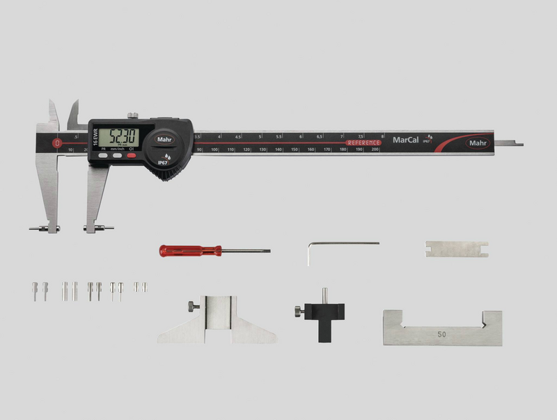

MarCal 16 EWR-V
Art. no. 4118807
Digital universal caliper MarCal 16 EWR-V
Measuring range mm: 0 - 200 mm
Resolution mm/inch: 0.01 mm / 0.0005 inch
Depth rod: rectangular
IP protection category: IP 67
Package contains: setting gage for inside measurement 16 Eel, measuring force device 16 Ec, depth measuring bridge 16 Em, anvils for outside measurement 16 Eea 1-3, anvils for inside measurement 16Eei 1-3, 4118808 without measuring anvils, adjustment bridge and measuring force equipment, battery, test certificate, instruction manual, case
- High contrast digit display
- Locking screw above
- Lapped guideway
- Step measuring function
| MarCal 16 EWR-V | Art. no. 4118807 | |
| Measuring range mm | 0 - 200 |
| Measuring range | 0 - 8" |
| Resolution mm/inch | 0.01 / .0005" |
| Error limit (mm) | 0.03 mm |
| Error limit inches | .001" |
| Standard | Factory standard |
| Depth rod | rectangular |
| Dimensions | b 48 mm | c 16.5 mm | d 285 mm | e 16 mm | |
- Can be used as a standard caliper (four types of measurements) with standard accessories to measure recesses, grooves, etc.
- Can be used with additional accessories to measure threads, bores and serration
