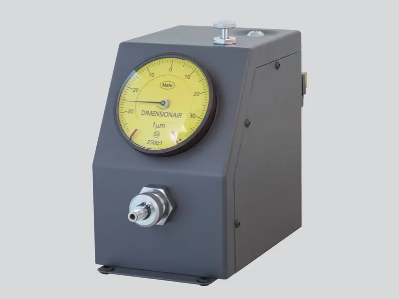

Millimar D-1250M
Art. no. 2095190
Dimensionair air gages (single master system) Millimar D-1250M
Range of analog display µm: ± 76 µm
Graduation mm: 2 µm
Compatibility: Federal
Magnification: 1250:1
Inputs for pneumatic measuring equipment: 1
Package contains: adapter for pneumatic plug gages, Federal compatible, air filter, supply hose AHO-2
- Operated with regular workshop compressed air (3–10 bar).
- An internal pressure regulator keeps the measuring pressure within the calibrated range.
- Zero offset of the instrument with just one setting standard and the zero adjuster.
- Clear display with fine scale graduation and needle-thin pointer gives an accurate, reliable readout. An integrated air filter removes dust and dirt particles from the air supply.
- Equipment connection on the front of the device. Hand tightening is sufficient for tight connections.
- No recalibration required after changing the measuring equipment. Measurement can be resumed immediately after setting the instrument to zero.
- 4 models available, choice of mm or inches
