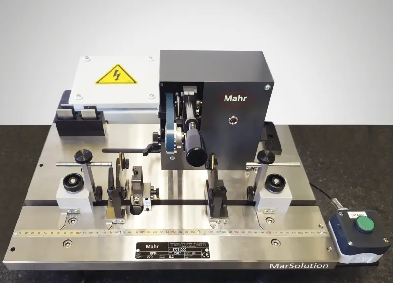

The new version of the MarSolution RPM measuring station offers even more flexibility, especially to manufacturing companies who test different types of commutators:
- Infinitely variable or universal settings of the prisms – instead of existing fixed positions according to customer requirements
- Different scales to help accurately position the prisms
Thanks to the various measuring scales on the measuring station, manufacturing companies can write work instructions or process descriptions in which the precise position of the prisms is defined for each commutator type.

Easy handling for an efficient measurement
The measuring station is operated directly in production. Here the worker can check the workpieces for their quality very quickly and yet completely reliably. For workpieces of varying length or dimension, the measuring system is adapted with little effort. The v-shaped bracket in which the shaft is placed and the stop at the end are easily yet precisely set for each workpiece. Thus commutator shafts with a length of 130 to 300 mm and a diameter of 4 to 20 mm can be tested.
Measuring time: 3 seconds
Dynamic measurement is possible, for example, since a rubber band turns the small commutator shaft and the fixed incremental probes thus reach the measurement locations. The special housing of the electric motor and the surface treatment of the V-shaped holders reduce vibrations and abrasion. The measuring station allows a speed of 3 to 20 revolutions per minute, and thus a measurement time of 3 seconds! Rotation is possible in two directions.
