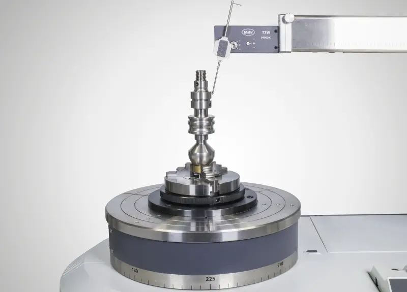

In the simplest case, shape measurement involves a probe and probe arm with sensing element. This is moved along an ideal circular or linear path to collect data on probe movements relative to this ideal geometry. The analysis is usually quite straightforward: the measured data points are filtered and mathematical operations are performed on them to determine the results. Although it is one of the most basic measurements used to support many manufacturing processes, some steps are often performed incorrectly. Particularly common errors occur in the choice of filter and probe element.

Incorrect Stylus Size A second common mistake is that users rely on a single stylus size to measure all parts, regardless of the size of the DUT. In fact, the stylus ball itself represents a mechanical filter that should be selected according to the part size and the maximum number of waves per revolution that can be measured.
The example of a small component with a diameter of 4 mm can be used to illustrate the problem: If the measuring surface is scanned using a probe with a probe element that is too large, it cannot run well along the surface and precisely follow the ups and downs of the peaks and valleys. If probing elements are used on a probe that approximates the size of the workpiece diameter itself, it becomes very difficult to get a good evaluation of the surface. In this case, the use of this probe element causes a mechanical filtering - even before any mathematical filtering is done. VDI/VDE 2631 Sheet 3 provides the user with a guide to selecting the correct sensing element based on the W/U settings, the maximum expected single-wave depth and the test specimen diameter.
