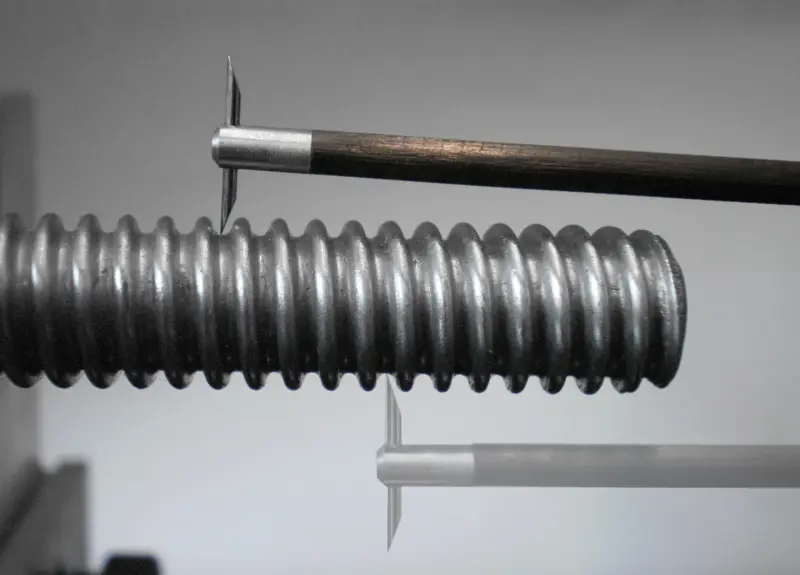

Fast, precise and fully automatic: measuring threads with MarSurf easyContour
Fully automated measuring sequences are very popular with users. With the MarSurf contour measuring devices and the software's measuring wizard, Mahr offers fully automated measurement of thread parameters: users who want to take a closer look at individual profiles and their thread specifics are provided with comprehensive data on the straightness and angle of the flanks as well as the pitch and radii in the thread root and thread tips at this measuring station. A fully automatic process is also available for evaluating the upper and lower profile. Inside, outside and flank diameters are evaluated in the blink of an eye.
In terms of dimensions, the MarSurf devices in the CD series impress with a measuring range of ± 35 mm vertically and 140 or 280 mm horizontally. This standard measuring station therefore meets the requirements of common internal and external threads.

A six-start trapezoidal thread with a large pitch and an outer diameter of only 10 mm places special demands on precise measurement. In order to obtain reliable results, a conical probe tip is used in such cases. This enables reliable data to be obtained despite the restricted geometry.

With the MarSurf LD140 and LD280 measuring stations, roughness and thread contour can be recorded simultaneously in a single measuring pass. The measurement is carried out precisely with a diamond probe tip (47° cone angle). The vertical measuring range is ±13 mm, horizontally 140 mm or 280 mm are available depending on the model.
