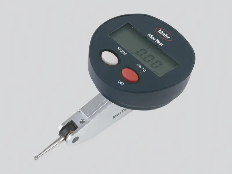

MarTest 800 EW
Art. no. 4305120
Digital test indicator MarTest 800 EW
Factory standard
Measuring range mm: ± 0.4 mm
Resolution mm/inch: 0.001 / .00005"
Package contains: spanner for changing the styli, stylus dia. ø 2 mm, mounting shaft 800a8, test certificate, instruction manual, battery, case
- Inductive measuring system, battery life of approx. 2 years
- Water- and coolant-resistant display unit
- IP65
- Combined analog and digital display
- Operating and display unit can be rotated 360°
- Satin chrome finished housing with 3 dovetail guideways
- Shockproof measuring mechanism, axes mounted in precious stones
- Automatic adjustment of contact direction
- Anti-magnetic model
- Ball-bearing mounted double lever, overload protection thanks to friction clutch

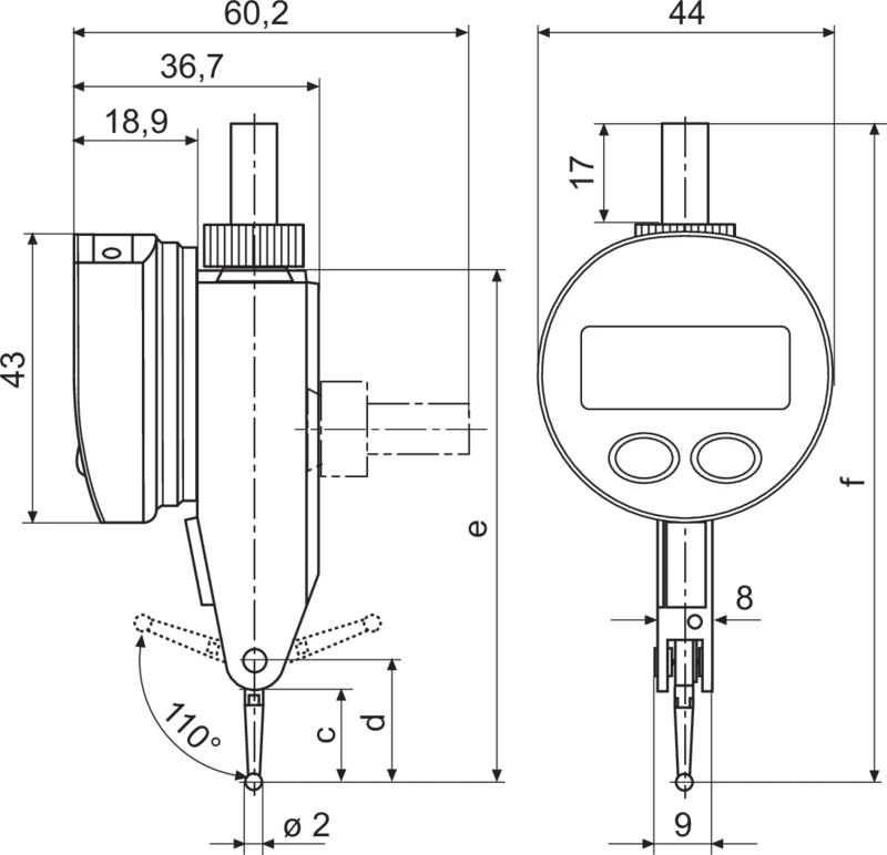

MarTest 800 EW | Art. no. 4305120 | |
Product type | 800 EW |
Measuring range mm | ± 0.4 |
Measuring range inches | ± .015" |
Display ranges | 0.4 - 0 - 0.4 (mm) |
Resolution mm/inches | 0.001 / .00005" |
Span of error fe (µm) | 10 µm |
Total span of error fges (µm) | 13 µm |
Partial measuring range ft (µm) | 5 µm |
Measuring value hysteresis fu (µm) | 5 µm |
Repeatability fw (µm) | 3 µm |
Measuring force | 0.13 N |
Battery type | CR 2032 (3V Lithium) |
Dimensions | c 13.6 mm | d 17.8 mm | e 75 mm | f 99 mm |
Label | Art. no. | |
Data connection cable RS232C 800 EWr |
4305122 |
Data connection cable USB 800 EWu |
4305121 |
