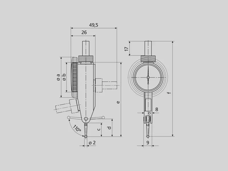

| Abmessungen | a 40.5 mm | c 13.6 mm | d 17.8 mm | e 75 mm | f 99 mm |
